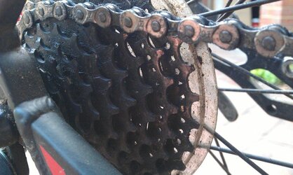

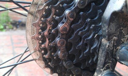

Can you tell from a photo if the cassette looks okay? (other than being quite filthy after my last ride).

Looking at that photo it appears to me that your 5th gear has the most wear but there is nothing obvious in the picture to say the cassette is past it. If that was my bike I'd be happy to put the new chain on and see how it went.
If it turns out that the cassette has worn out it will slip under load in the most worn gear.
Sorry if it sounds like I'm hedging my bets but as I'm judging from a photo I think that is the most reasonable answer I can give you.

I also thought it didnt look bad compared to my old MTB sprockets which had worn the teeth into weird asymetric spikes. Its only £7 for the chain and about £13 for the cassette if i need it, ill probably replace like with like and save upgrades for my next bike. I usually ride in 4/5/6 at the back so im more than happy to trust your judgement (as the alternative is mine) :smile:
I was a bit worried that I might be putting too much strain from grinding and trying to sprint my weight up short hills, being over 6ft about 18.5 stone and having strong legs from running and cycling regularly. I figure the fit guys must still put more power through, unless they just spin more so less power transfered through each chain link? Going up a short steep hill the rear axle on my raleigh mtb sheered under the cassette, so ive been a bit paranoid of extra wear and tear.
Thanks for all the replies, ill probably get a chain tool next time as im sure this ones over stretched already. :smile:

So, i upgraded the chain for the nice KMC X8.99 i found reduced on wiggle, easily fitted it and it shifts amazingly smoothly and runs silently. Unfortunately my cassette is so far past gone - it slips very easily in the 3 most used sprockets even under light pressure. For now ive put the old chain back on with a powerlink, so the bike works and to not wear the new chain.

Ah, shame it's too far gone.:sad: It's not always obvious how much wear is too much.
That cassette should be fine. Any matching Shimano or Shimano compatible cassette will do the job. If you haven't already got them you'll need the appropriate tools to undo the cassette lockring and to hold the cassette still while you do it.

After posting the photos, i read Sheldon Brown saying about measuring the chain over 12 inches, 1/16th over was okay, 1/8th over meant new cassette and mine was 3/16ths over, so i was kind of expecting it. Makes me wonder how many miles i would have safely got out of the chain, it might be better economy in future just to run a chain and cassette into the ground and replace both each time.
