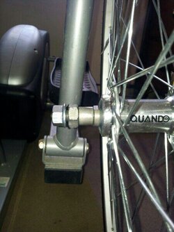

Got wheels and put a freewheel on. Because it is to fit in a smaller size frame i tried to take the axle end nuts off so i could remove the the large spacer and fit the frame. However the effort to just undo the nuts which i still can not budge has resulted in a alot of play in the axle. Can i ask Where did i go wrong?? What should i do??

I'm no expert on hub adjustments, having just recently done a few on my Vivente tourer/commuter, but I understand that the cone-shaped nut closest to the wheel must be very carefully adjusted to (a) remove any movement/play in the hub but (b) not be too tight so that the bearings wear out sooner. Try this site for some instructions that may help you: http://www.parktool.com/blog/repair-help/hub-overhaul-and-adjustment. It's possible that when you tried to loosen the outer nuts, that you also loosened the cone-shaped nut closest to the wheel? No doubt someone far more experienced that I will come along shortly to help you :smile:.

That big spacer with the hex on its left hand end acts as the lock nut. You need a thin cone spanner which goes on the two flats inboard of that before you slack off the big hex. You'll also need a narrower locknut to put back on (otherwise the cone will come loose of its own accord when you ride) AND you will need to re-dish the wheel to get the rim back central with the axis of the frame.

...AND you will need to re-dish the wheel to get the rim back central with the axis of the frame.
Just to add that if you're not clear about re-spacing the axle, it seems unlikely you'll have the tools or skills to re-dish the wheel without a bit of learning - it's not entirely straightforward. If you want to be riding this wheel soon, you'd perhaps best consult a good bike mechanic. (I say 'good' advisedly - many bike shops will just try to persuade you to buy another new wheel).

Update. A friend adjusted the the wheel and ok. Got correct spacers from LBS. No further issues with wheel.
