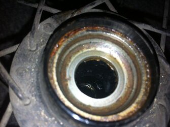

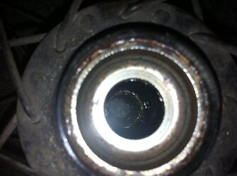

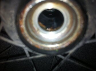

supplied are the pics of the cup which after closer inspect have cracks in them (bike mech mobilecycleservice) changed the wheel out (open pro at £115) and recommended contacting the manufacturesas wheel not even 1yr old.
Can't see any cracks but there is a lot of corrosion from an ingress of water.
This has flushed away the grease and without that the race has worn away.
Have you been cycling through deep water or using a pressure washer to clean the bike?
