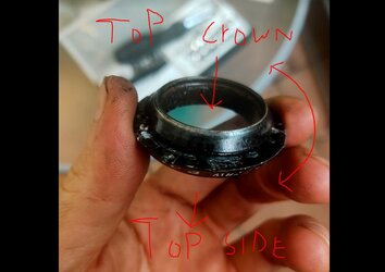

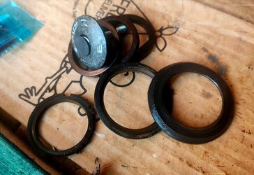

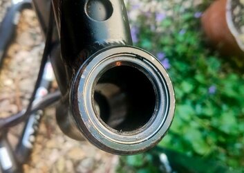

So I'm still at it. I went to Halfords and tried one that they recommend. It didn't fit at all, what a pity. If someone could enlighten me as to exactly what I need to buy that would be amazing! See below :laugh:

Where's the one Halfords sold you.
Also, It doesn't look like you've removed the cups from the old one. They look like they are part of the frame but they are not.
G
GoatBeard
Haven't included the Halfords replacement other than it appeared to be the wrong shape. Getting those inner bearings out of the frame is a bit specialised, I think you'd need that flared tube tool (trying to pry them our with a screwdriver would potentially score the tubes up badly I think) but regardless the bearings themselves seem absolutely fine. It's the rubber cups/seals that are perished.
I think I might just try and pack it up with grease and make do with the original headset. Seems like more trouble than it's worth.

Knock them out using a screwdriver and a hammer. Place the scredriver inside the hole and locate the lip of the opposite cup.
In a circular motion, keep tapping at the lip until the cup pops out. then turn the frame over and do the other one

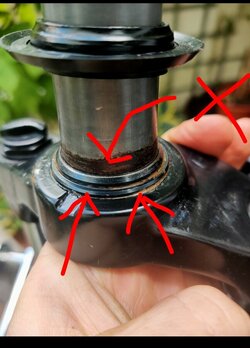

Is this collar supposed to come off the fork? Trying to replace the headset. Due to the rust I can't quite slide the new rings to the bottom of the tube. Rock Shox Dart 1.

Ooops, that should not have happened. Did you clean underneath first ?
Is your new headset a sealed cartridge unit, or a caged race. Show me the bearings
If it's a sealed cartridge, it won't matter. All the ones I've owned have a split race anyway, for ease of installation (you'll still have to clean underneath first though)

Thanks I'll see how I get on, I slipped the old crown back on (it's tight but not as tight as the new one so back on snug enough) everything was sanded, greased, but still. It's practically tapered at the bottom of the fork.
I actually only needed some of the inner rubber washers from the new headset kit so I might be ok. The original set is an integral type head set 1/18 one I believe - with the bearing collars on either side of the inside of the tube if that makes sense.
Seems all tight but if it gets wobbly I might need to try again, just buy another crown on it's own if it's possible.

As a matter of interest, run you finger on the inside of the steerer and check if it's not been repaired in some way. It shouldn't really have any kind of bulge at the base of the steerer at the crown.
