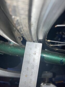

What are the biggest tyres I can fit on my old style steel tourer? I have Schwalbe Marathon 700 x 25c on but find these inadequate on local potholed roads and a bit skittery on paths. Using the tape measure there seems to be at least 10mm clearance on each side for a 700 x 35c tyre such as the Schwalbe Landcruiser but would these be deeper as well? Also would they be robust enough?

How much room do you have around your current tyres? Any chance of a pic?

Urgh! These close ups certainly show up the need for a clean! As requested Vantage, thanks to bonzobanana and Cycleops for your helpful feedback. Just to clarify my cycling is limited to short rides as much off road on paths as possible so that will influence my tread choice.

I would have thought you should be able to get 32s, maybe even a 35 in. But then there's the mudguard. As @iandg says the drop outs might give a bit more wiggle room.
