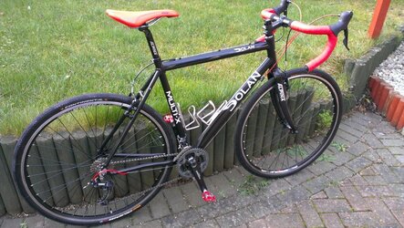

Decision made, tekro mini v's bought and fitted.....only concern was tyre clearance but no problem with the 35mm Conti tyres fitted, all in all a HUGE improvement, just been out for test ride and plenty of stopping power. One more issue to deal with, Deore front derailleur not compatible with STI's due to different pull ratio so Sora triple FD on order, then conversion complete. :-)
Please don't be surprised if It does not go as well as you have intended - mtb and road chainsets and therefore fd generally aren't set up for the same chainline, with the former being 47.5mm or 50mm usually, while road is 45mm. The implication is you might have trouble with the sora mech reaching for the outer ring, and I don't know what chainset you have but mtb and road fd usually have different ring size assumptions through different mech profile too. But you might be lucky and it works tolerably. If not, come back before jumping into other changes.
Thanks, good info. Did speak to my brother about this earlier as he's into touring bikes, he pointed me to a thread on the CTC forum which deals with this topic.
http://forum.ctc.org.uk/viewtopic.php?f=5&t=60930
The crux seems to be that with a road triple fd, although a 45mm chainline is preffered, they will work with a 47.5mm chainline. My Dolan chainline is currently set at 50mm but this can be changed to 47.5mm by switching the BB cup spacers. So i'm fairly confident the Sora FD will work.
Thanks RAFN, this post really got me thinking, if the correct size fd (31.8) would be expecting a chainline of 45mm and i could only achieve a chainline of 47.5mm at best, it could still struggle to change to the top ring correctly. Then i thought about how to move the fd a couple of mm so i changed my order to a 34.9 fd and used the existing shims when i fitted the new fd to gain an extra 1.5mm. Happy to report it works great and have full range of gears.
Glad to hear! If your fd shim is concentric which I think they generally are I don't think it would have changed the fd's reach, and I think within the same model Shimano fd's don't have different reach for variants with different clamp size.
