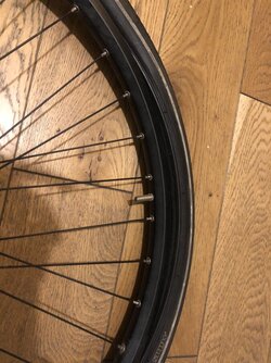

My wife’s bike has had first puncture. I’ve replaced dozens on my bike without issue.
Rear wheel new inner tube is pushing the tyre off the rim. Tyre says 700x40. I’ve bought continental 700 32 to 47.
Below is what happens shortly after inflating. I’m on my second inner tube and have rotated the tyre around. It always pops out where the valve is. It’s like the rim is not holding the tyre so as I inflate the tyre is pushed out of the rim on both sides.

Let all the air out first then squeeze tyre walls together going completely around the rim and then try again

Had this with a neighbour's bike, both wheels - sometimes the tyres aren't a good fit, especially cheap ones. You've got to double check you've got the tyre pushed into the rim, then check as you re-inflate it.

Fit the tyre. Push the valve in and push the beads of the tyre either side of the valve in with diligence. Pump 10 times. Go round each bead and check they are seated. Bounce, turn and repeat. Inflate to riding pressure.
I shall take it the rim says 19-622 and the tyre has 40-622 on it.
T4tomo
that lock nut isnt helping, take it off, as that is stopping the tube moving sufficiently into the tyre to allow the tyre beads to seat on the rim wall.

Thank you all that’s got it. I’ve normally just fed the inner tube into the tyre, pumped and it all works out.
I removed the nut and pushed the valve so the inner tube was well into the tyre, then fitted the tyre nicely into the rim. Pumped it up and all good. Are these crappy tyres I should replace or just make note of the process??
