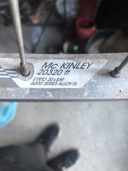

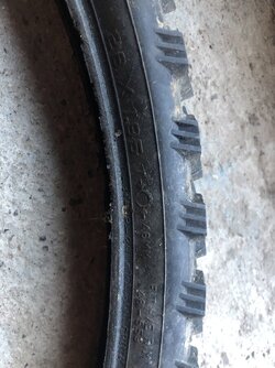

Hi all,
I’ve picked up a free bike & just need to change the tubes & fit new rim tape & new chain.
I can see which tubes I need to buy but I’m a bit confused as to why the rim I have shows a different number to the tyre the bike had fitted.
(Images attached)
Do these need to match? I would assume so but considering they were on the bike anyway has made me a tad confused!
Thanks in advance!

26” is old sizing, 559 is the Etrto equivalent. Any tyre with 559 in its description should be fine, the 20 on the rim likely refers to the internal rim width.

Last question! I’ve got 16x559 rim tape, is that too narrow? Should I have ordered 18mm?
