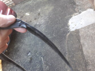

Hi I changed my tyre yesterday to another wheel got up this morning and noticed it was flat when I had a look the side wall of the tyre had blown and there was a big rip in the inner tube.
The wheel was in the bike off the floor it's a bit strange,the wheels had 25mm on them and the ones I've put on there now are 23 mm.

Happens - Conti's do do that. Tyre looks quite old.
It looked a tyre failure caused by a trapped inner tube on the bead, I’ve had it happened before but usually only on cheap tyres. Given the size of the gash the tyre also looks like it may also have been slashed previously (might not have noticed).
A trapped inner tube wouldn't do that. The sidewall of the tyre has failed at th bead and the inner tube has burst as it tried to get through the gap, causing the gap itself to widen.
It's not uncommon, most usually occurs in old tyres or where (as you noted) the sidewall has been compromised by road debris.

A trapped inner tube wouldn't do that. The sidewall of the tyre has failed at the bead and the inner tube has burst as it tried to get through the gap, causing the gap itself to widen.
As Si says. I have had a (should have replaced earlier 4000 mile on rear) Conti tyre (GP 4000S2 622-28) fail like this, with a loud bang, fortunately at slow speed. Tube was just like that and tyre had at least a 5cm split just above bead. Combined use of carried tyre boot and a £5 note got me most of the way home before it failed again.
