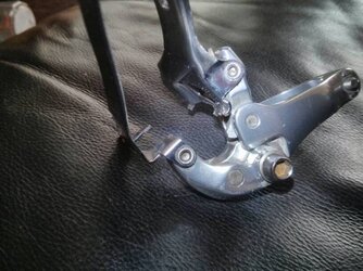

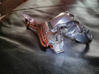

Well here she is one shift too many !!

I am sure someone on here will know but I think triple mech is fine to use with a double. You just set the limit screws for your setup. The mech is not indexed, that's the shifter. I am sure someone will clarify.

I've found a 105 9sp double which I have ordered let's hope it fits
