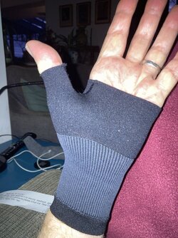

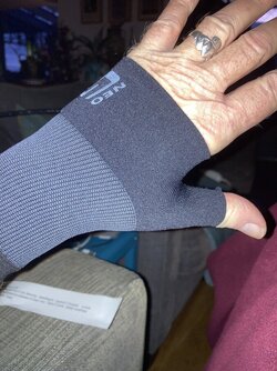

Neo G thumb support and grip shift has resulted in a great deal of improvement in pain relief after a quick ride today.
