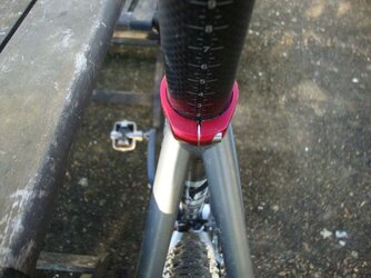

take a look at the clamp ends - I have found that on some non Q/R clamps, as you do them up, the clamp itself starts to bend i.e. the clamp end faces are no longer parllel - meaning the clamp is not getting tighter on the seat tube. The solution I found was to fit a washer in the gap - as the clamp is tightened, the ends will meet the washer so the inner part starts to come together. Obvioulsy the thickness of the washer needs to be selected so that it it thin enough to clamp the seatpost tightly - it also will prevent overtightening = important for CF posts.
Not sure that is explained well, but here is a photo. There is a washer in the gap - the outer part of the clamp ends are up against the washer but if you look carefully, the clamp ends are not parallel as there is a tiny gap between the ends and the washer nearest the seat tube.
Yep, you explained that perfectly well thanks :smile:. I've just checked the gap with verniers and it's perfectly parallel front to back , top to bottom
