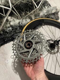

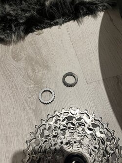

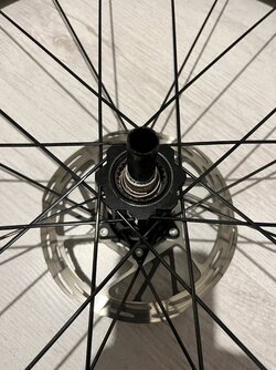

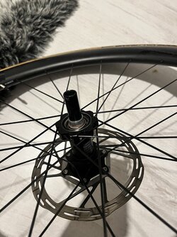

Alex1982
Scotland
Took the cassette off
Anything missing or clearly not right?
A
Alex1982
Scotland
Think ive fixed it but not very tech savvy - I put the two (3rd pic) into the wheel and put the cassette back on (I couldn't tight it though the way I would normally tighten a cassette)
Can free wheel and backpedal now
