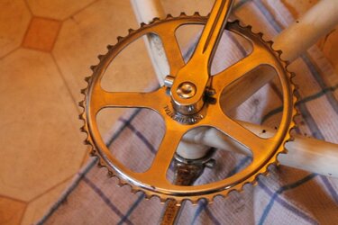

How do I go about this?

It's down to the Irish screwdriver you used to remove your steering stem.
Position the frame on a block of wood under the bottom bracket. or rest it on the edge of a solid bench. Replace the nut onto the cotter pin and screw it down until flush with the end of the thread. This will help prevent the cotter pin thread bending or mushrooming when you do the next bit. Make sure everything is secure then give the cotter pin a few good whacks with your hammer. Be warned though, they either come out easy or they can be pigs. Just make sure you keep the frame supported on a block to stop the frame absorbing the shock of the hammer. You want all the force to go through the cotter pin not through the frame!
I used to use a block of hardwood with a hole drilled in it. The head of the cotter pin went in the hole and the crank was supported on the block. A 4lb lump hammer works well as long as you don't miss and hit the frame.
sidevalve
+100% the above. If the wood fails try a steel bar [socket extension] under the crank arm for support onto concrete or brick floor. Very violent but sometimes the only way.

Follow Compo's excellent guide but the one thing I would add is to hit it and hit it hard. One or two good hard whacks is all it will probably need. Careful aim and force is the key. A claw hammer may be better as it's easier to aim than a lump hammer. If you sit tip-tapping at it, you will end up riveting the pin in place.

Oh yes sorry in the photograph I didn't have the nut screwed on but I do have it.
So I screw that nut down tight, and then hit it very hard with a hammer?
I'm hitting the threaded end right?

No, don't screw the nut down tight or the cotter pin wont move. Leave a gap between the crank and the nut. The nut is only to stop the thread on the cotter pin ballooning or bending.

So where abouts should I screw the nut to?

UPDATE : The bolts came out like a dream, one hit and bang. Out. Lovely!
I took the crank arm off, but I cannot get the crank off on the side where the chainring is.
Any ideas? Help?
