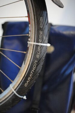

There are alternatives...
I did the traditional 18+ mile commute last night, arriving to some 6 inches of snow about 3 miles from home. Hard going from there on the 'bent, except for one cheap and cheerful interim fix using (ah, you guessed it) zipties.
Cheapy grip worked a treat.
I would like to try that but not all my bikes have rim brakes...
