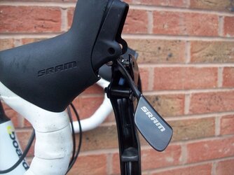

1st clipless tonight so how do I go about straightening out my shifters if that is what they are called.
They work fine but now are just at a stupid angle.
I did try and briefly push them back but they are solid.
The corner took the whole weight of the me and bike going tits up in the hedge.
Flat pedal are now back on at least for the time being. i don't mind taking a fall but dear god don't hurt the poor bike :sad:
Prise the side flap of the hood back and that will reveal a hex bolt. Undo, straighten and then re-tighten.

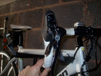

This is what mine looked like after my pothole incident ...
It is bent at 90 degrees and the brake lever has ben pulled off.
I managed to bend it back and get the brake lever back on , i hope it has not been weakened to much as the LBS quoted me £210 to install a new brifter. .. thats right for just i side.:wacko:
Even the usual discounters have a set of Apex shifters at £289... £210 to supply & fit a single one is probably reasonable.
