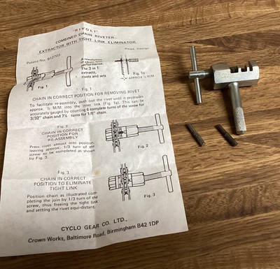

You don't need to completely remove the rivet. Just put the link in the chain splitter's first set of teeth and turn the handle about 1/3 of a turn. This will be enough to losen the link.

Are you flexing it sideways? That's the way to loosen a stiff link. Otherwise, use your chain tool in the 'easing' position - prongs in the middle of the links - but go very easy.

Think I know what you mean but can you elaborate on this easing position maybe with a diagram or link to a video maybe, please

Agree with the use of a chain tool but I've noticed some of the chain tools don't have an option for loosening a tight link i.e two positions to place the link. I wouldn't take a rivet out and mess with it. You'll never get it back in.

Flex it as hard as you like - unless you're King Kong.
Midlife's diagram shows how to use the chain-tool. But start with less than a quarter-turn, and visually check the pin is still fully engaged.
