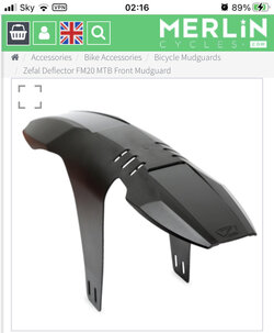

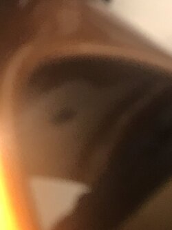

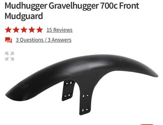

Hi All
Would like to fit mudhugger gravel front mudguard on my bike RIbble 725 but not attach using the advised zip ties around the forks etc
Bike only has a normal sized steerer tube screw thread fixing option - mudguards have no mounting etc
Que - Is it as simple as drilling a hole and fixing ? I’m sure from the above you can rightly assume I’m in the “Bodge it” category of mechanical knowledge!
Thoughts suggestions advice gratefully received

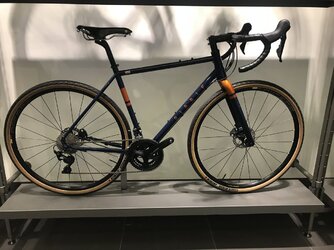

First pic is a slightly blurred under shot of steerer tube fork with mounting hole then two potential examples of the type of mudguard lastly general pic of bike
Hope that helps

If that is a Ribble CGR 725 as I suspect from you picture, you won't want to drill through anything on the fork as it's carbon. Why not go with the SKS P45s (or 65s if you have 650B wheels) that Ribble sell as an option with the bike?
