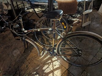

I found it on the same spot where I found the ALPINA, and I have a feeling the coordinator of the volunteering project will have even less problems parting with it, than with the ALPINA. Here comes the bride:
A lugged steel frame, 3-speed internal hub gears, the frame and forks are thoroughly rusted, as are the rims and at least some of the spokes. Everything rotates freely, the shifter works and the original seat is in a very good condition, so there are some upsides. The frame will need to be repainted (should I accept the mission) and the wheels rebuilt with new spokes.
The stickers give off a strange vibe, extremely over the top model name and a sticker instead of a proper head badge (more on this below):
Could it be the stickers are non-original?
The gears chain is on the left side, which seems unusual to me:

I started taking it apart today. It's actually going ok - I was able to remove the bolt of the seat post clamp, and the seat post can be rotated - that's good news. I took off the mudguard, both calipers, the dynamo and a few other things. But as I worked doubt kept creeping in - the amount of rust is incredible, and it's everywhere. It never seemed a minor project, but as I was trying to loosen the shifter's clamp, I started thinking maybe I bit more than I can chew - and for a rather modest payoff. We'll see how it goes. Maybe if I don't have any other project to work on, my motivation level will increase. And also once the bike is in pieces and I can attack them one by one, it will no longer be this demoralizing heap of rust.
dimrub
dimrub
This bike now fits in a box:
Everything came apart relatively easily - certainly easier than I expected. The drive side part of the BB is still there, and a cotter pin on one of the crank arms refuses to come off, but other than that it's all apart - only one bolt needed to be cut. Maybe it's doable after all. Next step is cleaning everything up, and this can be done one part at a time, which makes the task much easier.
I know what color I want the frame to be: a very dark green, if I can get my hands on a can of such a paint. Also, I think I'm ready to invest money in this project - i.e., measure the spoke lengths and order new ones (as well as buy the paint, of course).
