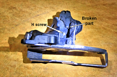

It's been a long time since I needed to adjust the front derailleur but today I checked it out after hearing a clicking noise. I was successful but have an issue I can't figure out. The high limit screw doesn't do anything. I can screw it all the way in, and unscrew it all the way out, and it makes not the slightest difference to the cage. The only adjusters I have are the low limit screw and the barrel adjuster at the shifter. I looked into the inner part to see what the high limit screw butts against but I see nothing.

The mech is parallel to the large chain ring, and the correct height above the teeth. I'm not blindly adjusting, I followed Calvin Jones' precise instruction. When he adjusts the H screw the cage moves. When I adjust it, it doesn't move. And like I said, I can see nothing that the screw butts against. It should have something, though.
When I bought the bike, new, from the bike shop seven years ago, they hadn't checked anything, and fifteen miles from home the chain came off the large cog, going up a gradient and got jammed. It took me ages to get it out and back on the cogs. When I got home I found not only did the chain go too far on the large cog, but wouldn't even go on to the smallest cog. The front mech was out, too, and I set both of them. Everything has been fine for seven years and 13,500 miles. It was just the slight clicking sound that made me look for the cause. The front mech needed adjusting, and that's when I found out the H screw doesn't do anything. I can screw it all the way in and the gears all work well. Take it right out and the gears work well.

I was right about not being able to adjust the H screw. I took the front derailleur off the bike and examined it closely. I said the H screw doesn't butt up against anything. The reason it didn't is because the part it's supposed to butt against was broken off. It's yet another botch job that was performed by the Specialist dealer. Eight botch jobs in all, across three new bikes. I only stuck with them for a while because they were nice guys. Thirty-nine years in business when I bought the bike seven years ago. I kept thinking the botches were just aberrations, but later I realized they have a trainee in the repair shop and he wasn't being supervised. He did some diabolical things to the bikes. I did tell the dealer about that but he just shrugged it off.
So I put the derailleur back on the bike. The thing is, the gear changes are perfect even without an H screw adjustment. It's been this way for seven years so why bother with a new derailleur now?

X5 is a lower end range. It will work well if maintained, but it's not going to last a regular rider very long. too much plastic in the construction.
Just get a new one.

I believe it just broke by itself. You set the FD up yourself and it was fine for 7 years. Stuff breaks.

We've got X5 on 'the kids' bikes ! Its good enough, but the OP's mech has probably cracked at some point causing the clicking.
