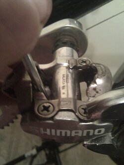

M520! When this happened to me (2Loose by nature) due to loose cleat bolts, I had to;
1. Loosen the clip as much as possible by screwing the hex bolt in as much as possible.
2. Using an adjustable spanner to provide grip and leverage on the pedal.
3. I used a long thin hex key to lever the clip open while applying leverage to the spanner - allowing the cleat to fall out. A tent peg\screw driver or do - as thick as you can fit in between the pedal cage and axle with the cleat in place and as long as possible for extra leverage.
Picture attached.

I used your screwdriver technique in the end Globalti. It all went well and there seems to be no damage to the shoe plate. So I am now left with 2 cleats, 3 screws and one of those cleat adapter plates. I will buy a new set of cleats and keep these bits & pieces as spares. I take the point about tightening the cleat bolts but was warned about overtightening. Do you use a threadlock and if you do, which one is best?
