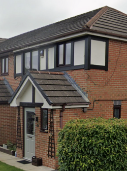

I have an up and coming project for the summer, or at least a period of nicer weather.
My house has small porch over the front hallway and downstairs loo. The house is a 1999-2001 built job with timber facias and soffits. The roof is pitched with Marley tiles (approx 30) over traditional bitumen type felt, there are no gutter tray / eves protectors. This small roof has had no work since being built (other than a small amount of pointing around the flashing). There is no internal access to the roof space / attic.
The issue is that the felt has rotten around the bottom of the roof and no longer guides the rain into the gutters causing the paint to flake etc
The plan is in around 3-4 years to have the facias and sofits replaced all around the house, including the main roof.
My initial plan was to just get some eves protectors and slip them under the bottom row of tiles and tart up the paint before the wood gets damaged.
However; I am generally not one for bodging and generally like to do a job properly.
I feel a mini project coming on. My current plan is to strip off the existing tiles, numbering them in rows, stacking them up, leaving the flashing on.
I expect that there is no insulation in the mini attic above the hall and loo - I couldn't find any when I cut an 8" hole for a light. - This might explain why despite heating it feels colder than outside in the downstairs loo.
Stripping off the battening and old felt.
So the plan is to insulate the attic space from above, probably with celotex type stuff between the ceiling joists then another layer at right angles allowing space for a draft to blow.
I have a roll of that new modern fabric type underfelt left from when I put a "proper" roof on the conservatory so was planning to use that to line the roof, install gutter trays, then re-install the tiles / battens, verge.
I could then replace / repaint the facias and gutters if so wished / depending on condition.
Does anyone see any issues with my proposed plan?
- The tiles are around 25 years old and while weathered don't show any signs of deterioration.

Architect here, so I've seen hundreds of jobs like this.
My only comment on your plan is that there doesn't seem to be any good reason why you'd number the tiles or expect them to go back in the same place. Save yourself the trouble. You didn't say whether you were using new battens or expecting to re-use the old ones. Definitely replace them, as the old ones will be damaged by removal, and obviously use new nails.
My final comment would be to please ensure you have safe access. A scaffold under each eave is essential, and ideally with the bottom edge of the tiles at about knee height.
MikeG
Suffolk
Oh, as an afterthought. Don't buy gutter trays, but just cut some strips from your roofing felt for the purpose. I think bought stuff is about 400mm wide, from memory, so just select some better felt from high up the roof and cut it into 400mm wide strips. It's the same stuff.
Thanks for your comments;
I was going to replace the battens, I have a bundle left from building a trellis.
The reason for numbering the tiles was indeed to stick them back where they came from, to avoid new cuts and new tiles (as long as I don't break any). I don't have an issue with cutting them but a new tile amongst them would bug me! I was hoping if I put the new battens back in the same place as the old battens it should all go back together... No?
Access shouldn't be an issue, it's low single story and I've got access to a trestle platform - it probably won't be HSE approved but it's better than a ladder. That said when I stand on the roof to put the Crimble lights up or clean the widows I jump off anyway.
Tom B
Tom B
Lancashire
I was thinking these sorts of things? From the conservatory roof they are more rigid PVC and despite a south facing aspect do not appear adversely affected by the sun.
MikeG
Suffolk
That's the proprietry solution, and of course that's perfect for the job. However, roofing felt is a perfectly accepable alternative. Entirely up to you.
As for the tiles......just get your battens back in the same place and the tiling will work. The cut tiles will be the only ones which need a set place on the roof. All the others can go anywhere. The thing I would worry most about an amateur doing on a roof is the undercloaking and pointing. The rest is easy.
