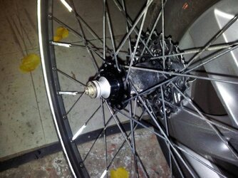

On my 15mile commute home yesterday I thought the rear wheel 'felt a bit funny'. Rode ok though.
Tonight I stripped the cassette off to give it and the chain a good clean. While doing that I noticed that (excuse my terminology)
A) the freehub (splined bit that the cogs slot onto) was fine
B) the axle (bit that the quick release skewer goes through, silver bit in the pic below) was able to rotate awkwardly independently of the freehub and feels like it's on a ratchet. Kind of like the cassette lockring feels when you tighten it up if that makes sense.
C) with the wheel back on the bike there is a small amount of play when moving the circumference of the wheel from side to side. Millimetres at most but enough to feel a slight clunk
D) with the bike upside down and spinning the wheel as fast as possible there's an oscillation, enough to wobble the frame.
The bike feels solid enough when ridden. On a scale of "pah no worries" to "omfg Mick don't ride it until an LBS has looked at the wheel" how seriously should I take this?

Sounds like the bearings need a slight adjustment on the preload if they are not running rough. Ignore the oscillation as that's wheel tyre tube weight when spinning.
The tricky bit is knowing the hub. What hub is it. This Will help in finding out how to adjust the bearings and or change them.
The hubs loo like they may need an Allen key into the hollow axel to undo, but its very dependant upon make.

Looks like they are novatec so you can google them. Looks like cartridge bearings if needed, and once they wear they do indeed produce some movement. Got new bearings on order for my cartridge bearing hubs on my fixed as they show some play now.

Took it in to Race scene in Barnsley. Glad I did, they said it was close to collapse.
Anyway, wheels left with them for a service and I bought a pair of Mavic Aksium. Now I think about it the clicking noise from the Mavic freewheel sounds obvious now and I wonder if the others went a while ago and I only just noticed.
