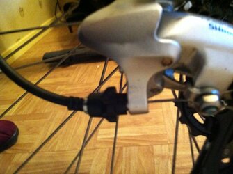

Thanks Hawk. Would that be the black plastic adjusting screw I have tried to show here?

Looks like that's it. So what I'd do would be put the derailleur to lowest tension setting (smallest cog, almost certainly). Then I'd pull the cable taught and clamp it with the bolt as it is already. After this, I'd tighten that cable barrel adjuster so the bike reliably changes up (to higher tension settings) and then maybe a half turn more. Should sort it for you

That sounds quite straightforward. Many thanks. :smile:

Many thanks, tighten the rear derailleur with the barrel adjuster and it seems fine now.

Worth noting that to tighten the cable you turn the barrel adjuster anti clockwise. Also i think when you release the cable to reclamp it you should probably screw the barrel adjuster in by turning it clockwise pretty much all the way, then reclamp the cable, then turn it anticlockwise to add tension until it shifts correctly up all the gears.
Im sure Hawk can explain it better than me, but as Mo said she had no knowledge I think the extra info might be useful if someone can confirm it. :smile:
