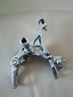

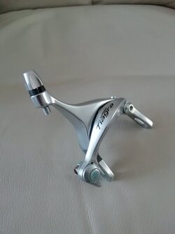

I've got this Shimano Tiagra brake lever.
Is it for the front or the back brake? Or can it be used for either? Thanks

Thread not closed (and not a daft question). Thanks for the info.
From the photo below, the shaft is about 27mm. So is it front or rear?

That type of bolt is designed for front fork. But it’d be easy enough for you to put on your front fork and see. Some fork crowns are deeper than others.
raleighnut
That's actually an example of how I came by my 'username' on here. Someone posted about drilling out a rear brake bridge to fit a modern caliper with a 'sleeve nut' to an old Raleigh* and I passed on a tip I'd been given, if you use that on the rear and simply fit a suitable sized 'nylock' nut then you don't need to drill the back out to fit the 'sleeve nut'
* the Raleigh in question had a thin tube as a brake bridge and to drill it to 10mm to fit would have left it dangerously thin, this trick also works on other brands of vintage bikes too.

And also re @raleighnut comment above the Allen key inserts come in different lengths so with a long one sometimes and only sometimes you can use a rear on the front.
But then the cable could look odd as it will be on the wrong side.
