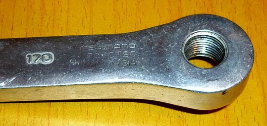

I have just realised that I have a CT90 Altus triple crankset. I understand this was part of a massive recall due to risk of it breaking.
Is this recall ongoing or has it finished?
Can I get my cranks replaced without paying for it?
If so where do I take them?
Cheers.

It is the original CT90 set I have. It is the FC-CT90 that was recalled. Shimano launched the CT91 set in 1997 when the recall was issued.
I'll have a ring around tomorrow.
I have also e-mailed Shimano UK service centre.
No harm in trying eh, doesn't cost owt?

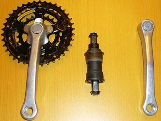

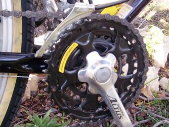

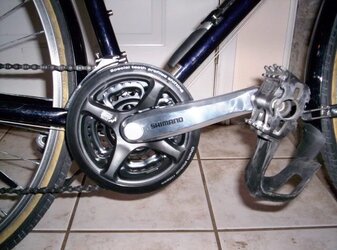

This is what is being replaced and what the replacement looks like in the first 2 photos and mine is the last picture:

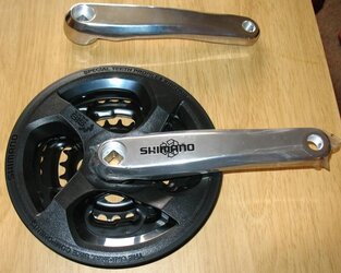

Here's my replacement chainset
Shimano FC-M131 Tourney 24 34 42 compact
Looks like mine was an Altus CT90 set after all.
