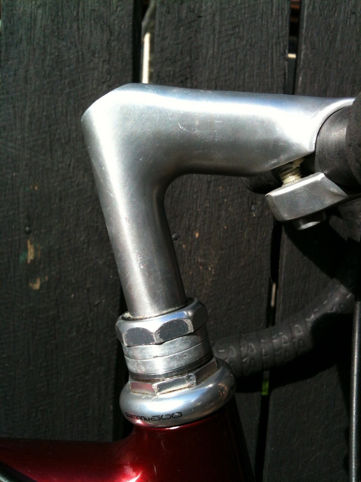

Note that not all "clamp bolt behind the handle bar" style stems are made as inferior as that design, which appears to be particularly bad. Yours probably looks something like this, which is a very different design. In fact, I've never seen another stem similar to the one on Sheldon's page, probably for very good reason.
Either way, if your older stem has made it this far (most likely 30 or so years since it was cast, if not more), you can probably stop worrying about design and manufacturing flaws. It's still worth inspecting it for fatigue/cracks etc when you do your standard bike clean/maintenance, however. :smile:
