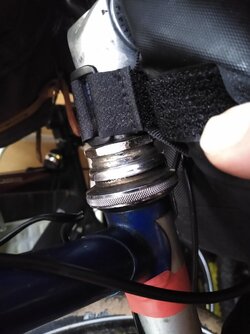

Sadly I have only one lock nut, it goes knurled nut, two interlocking parts ( that don't seem to do anything) the washer/cable hanger then one lock nut that is round at its base, hopefully the photo is clear.

Well I've been 'working from home' today so was able to have a play, I'll need a decent test ride (pouring down now, naturally) but after adjusting the knurled ring and tightening down the only top ring (took a few attempts to strike the right balance) I'm hopeful of a good outcome, I need a good bouncy downhill to test it out proper though.
I think I mustn't have been finicky enough after its last clean/ grease setting the resistance before locking down
Thanks everyone for their ideas and experience, if the test ride isn't great I'll feedback and might be more involved and beyond me and my tools
