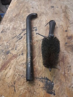

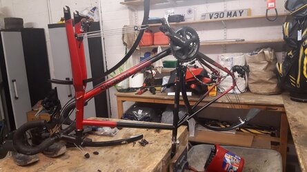

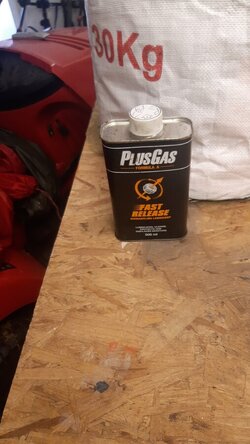

So I pulled all the seat posts from every bike in the stable towards the end of last year, but couldn't believe it when I finally went to do the Genesis (obviously the workhorse in the stable) and the seat post was already seized. I wasn't looking forward to wrestling with it so kind of forgot about it but planned to take it through to Stirling to a guy who specialises in these things. Anyway, I was fettling something else on the bike today, and I found some plus gas in the back of a cupboard, so I thought I would stick the steed in the vice and see how I got on, and voila. My question is though, should I replace my seat post or would I be OK with cleaning and greasing the original?

Clean and grease the seat post, and clean inside of the seat tube as far as you can. It'll be fine.
Slick
Slick
Brilliant.
I cleaned inside the frame with the brush in the picture but I'm sure there is a bit more to do. I thought about taking some emery paper over the seat post and maybe coating it with some spray pain, but I'll clean it as best I can with a scouring pad and grease her up for the season ahead. :okay:
