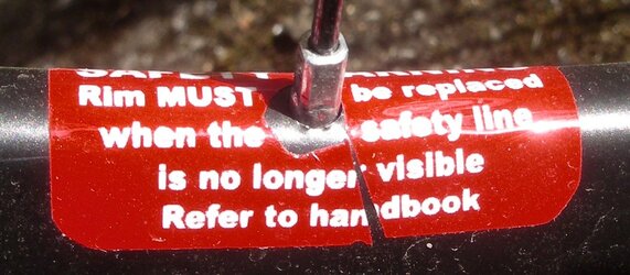

On my daughter's new bike (a Saracen) there is a sticker at the base of a spoke that says "Safety Warning. Rim must be replaced when the safety line is no longer visible Refer to handbook".
There is nothing in the handbook about it and no reply from the bike shop yet.
Anyone know anything about it?

The safety lines are the grooves running around the circumference of the rim. When using rim brakes of any type, the rim eventually wears down. When enough of the rim has been worn down that you can no longer see the groove then it needs to be replaced. This doesn't apply if your bike has disc brakes of course :smile:
If you take another photo of the sticker, but this time show the rim as well I can show you the safety line.
LosingFocus
Lost it, got it again.
I luckily have a wheel sitting next to me with the same sticker on:
You can see the groove near between the curve of the rim and tyre wall.
