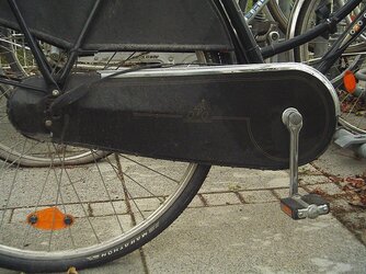

Get yourself hub gears and a chain case and oil your chain annually. Bike_chain_guard_full.JPG
