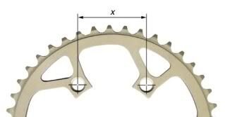

Well a triple will give a lot of easier gears for hill climbing ,with yours you need to find out what size chain set you have by measuring the distance between chainring bolts as shown below to see what variety of chainring you need.
Most compacts are 110 bcd.
After that you may need to adjust your chainlength.
Distance (x) BCD 5 hole chainrings
34.3mm= 58mm
43.5mm= 74mm
55.4mm= 94mm
64.7mm= 110mm
71.5mm= 122mm
76.4mm =130mm
79.5mm= 135mm
84.6mm= 144mm
4 hole chainrings
41.0mm= 58mm
45.3mm= 64mm
48.1mm =68mm
73.6mm =104mm
79.2mm =112mm
