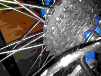

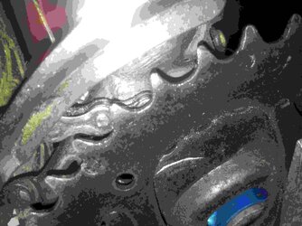

If you are only keeping it going then I would be tempted to leave it as it is, if it is running fine at the moment. You are probably right that the other bits would need replacing at the same time. As for when they need replacing, look at them closely - the curves when new are approximately symmetric, whereas once they are worn they become asymmetric - bit like sharks teeth.

Post a photo if you like of the worn bits.

Front and rear cogs attached.
