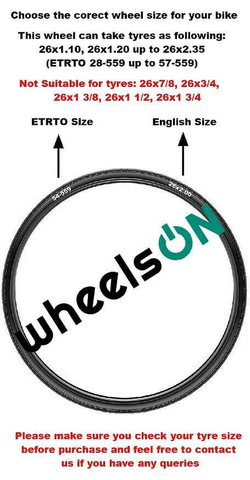

I'm baffled by two aspects of the descriptions though. Could someone kindly explain the following:
What measurements do these two numbers (I assume the units are mm?) refer to? Double wall aluminium rim 559 x 19
And this guidance on suitable tyre sizes confuses me.
1669745136618.png Why is this rim unsuitable for 26x1 3/8 and 26x1 1/2 and 26x1 3/4 tyres when it's suitable for tyres 26x1.20 up to 26x2.35? (i.e. The range 26x1.2 up to 26x2.35 encompasses some of the tyre sizes that are listed as unsuitable). I don't get it.
Hope someone can clarify, thanks.

Tyre sizes are rather messy, but the bottom line is that the bead diameter of a 26x1.5 is not the same as the bead diameter of a 26x1 1/2 tyre.

The 26 x 1 3/8 tyres etc expect a different rim size (I know), but don’t worry about it, for mtb you want the 1.75 type tyres anyway.

That's a good example of the perennial confusion of tyre size description. The best way (most accurate) is the ETRTO sizing, which few people quote. So any tyre with -559 is a match for your rim diameter. The first figure is the width, so 28-559 is a 28mm wide tyre to fir a 559 bead diameter rim. The width can also (but not usually :smile:) be an issue. As a general 'rule' the thinnest tyre should be no thinner than the rim width, and the fattest tyre no more than 1.7 x rim width.
Good grief, what a mess!
I currently have a 1.75" tyre fitted so wish to utilise that on the new wheel. However, rim widths of current 26" MTB wheels I've seen so far have been quite narrow at 25mm (outer surface to outer surface of rim) and if I stick to a max. tyre width of 1.7x rim width, that's only 1.7 x 25 = 42.5mm or 1.67", so a 1.75" tyre is outside the recommended range (only just mind). The outer rim width of my current knackered wheel is 26.5mm (as measured with a vernier caliper) so 1.7 x 26.5mm = 45.05 or 1.77" which is just within the recommended range.
Or maybe I'm misunderstanding what a 1.75 tyre is?
