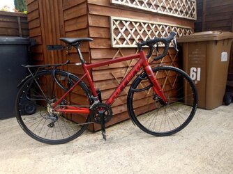

She said the stays are too short, I don't think they're adjustable. I think the rack needs levelling. It's a five minute job to check before going to the expense of buying something else. I've a similar style of rack and mine will pivot at the point where its attached to frame to allow leveling.
i dont think you can get the rack level as the arms are too short to allow it to do so and connect to the arms to the frame ?
