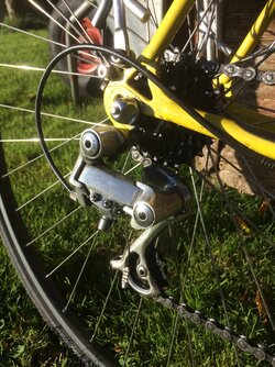

My wife's touring bike has a 7 speed freewheel, 11 to 26 but she wants to have a larger big sprocket, up to possibly a 32. How do I know whether the rear mech will be able to cope with the increse in size? It is a Campag set up, and one web site I looked at said that Campag rear mechs have a small, medium or large cage, but with no indication of how to determine this. The mech isn't marked in any way that I can see. Any help would be welcome!

Need to know the number of teeth on the largest and smallest chainrings and the model of the rear derailleur. Also measure (in mm) the distance between the axes of the jockey wheels.

If you could provide a pic of the mech it would help identify if it could manage the larger sprocket. If not you could probably fit a wolf tooth gear extender.

Thanks for the interest folks. And yes it is a freewheel, but 13 to 26, not 11 as I first posted, sorry! The triple chainrings are 24, 36, 50. I think if she will limited to going to 29 then she says she will be happy. I have attached a picture of the Campag rear mech, well used but still going strong. The distance between the jockey wheels is 65mm. I have attached a picture of the rear mech for interest's sake.
If you can't go up at the back, then why not come down a couple of teeth on the front instead?
Sheldon Brown's website has a gear calculator thingy, so you can work out the equivalent. And then, Spa Cycles can furnish triples or individual chainrings in all sorts of sizes.
