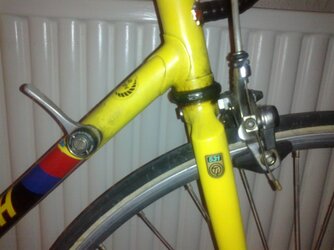

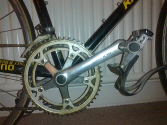

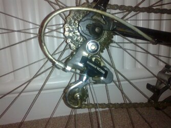

201546_10150183544178373_722183372_8311412_2123390_o.jpg 201546_10150183544198373_722183372_8311415_1201214_o.jpg
Hope the attatchments work as I only joined yesterday. Thanks for the HG50 recomendation, looks like just what I wanted, think you're are right that I need to take it to a bike shop and hope they dont try to rip me off.
mcshroom
Bionic Subsonic
Are you sure that's a cassette rear wheel? It looks like a 5sp freewheel to me. (Difference between the two here)
Also looks like you have a 52-42 chainset. This bike is defintely not geared for loaded touring. The HG50 is pretty good (or the SRAM P850) if it's a cessette, if it's a freewheel then a Shimano Megarange freewheel should give you a 42-34 bottom gear which, although higher than I'd like would give you a lot more scope on a hill.
That 105 rear mech looks like it's a short cage, so I would guess it wouldn't handle a large rear cog. As for replacing it (if you do) then anything shimano compatible and mtb range should work. Deore is nice but even Tourney works efficiently enough, and at £8 you could fit it just for the tour then change back afterwards if you wanted.
