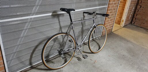

I bought my 1977 Raleigh Grand Prix a few years ago with the intention of restoring it to original.
This is how it was when I first bought it- 10 speed, steel 27 x 1 1/4 wheels, centre pull brakes. The frame suits me as it's a 25 inch frame and fits me well at 6'5".
I did restore it eventually but found I wasn't riding it too much as I had other bikes that were similar so I made it a bit more unique.
This is the end result:
A flat bar conversion, 3 speed Shimano hub gears, dual pivot mid reach shimano brake to handle the 700c wheel conversion and 700 x 28 tyres.
Most parts were from a donor bike, in fact all that's original is the frame, fork, bottom bracket (reversed to get correct chainline) and rear brake).
It gets a lot more riding now.

Flat bar conversions are good.
Nice choice with 3 speed hub
I would have kept 27" wheel size although I would use alloy rims

I would have liked to but the hub came with the 700 wheel and made tyre choice easier. I did have aluminium 27 inch wheels on that I had built for it, they've gone onto another project.
Here's a photo of that one, I'll do a separate post of that bike.
