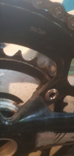

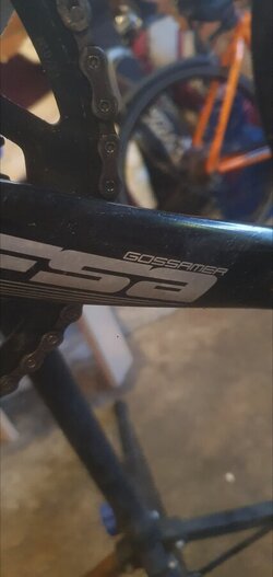

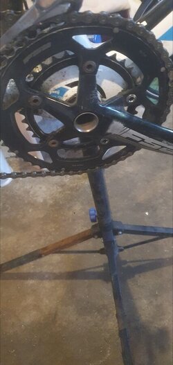

Jimmy Welch
Cycleops
Accra, Ghana
"will this new chainring fit with the existing bb".
I think you mean will the Shimano ring fit the spider on the FSA crank? The BB doesn't come into it. Don't know how you'd find out, a visual check might not suffice. Perhaps someone on here who has done this might know.

Hi sorry no I want to fit a whole new Shimano 105 11 50/34 or 52/36 chainring on my mates bike without a load of faff on the the bb
J
Jimmy Welch
I recently fitted a 105 on to my bike but this had a threaded bb housing and the hollowtech went straight in this is a push fit only frame
Cycleops
Accra, Ghana
Oh sorry. I think you'll need to use the Shimano press-fit BB as I can't imagine Shimano spindle would be exactly the same dimensions as FSA. Unless someone knows different.
