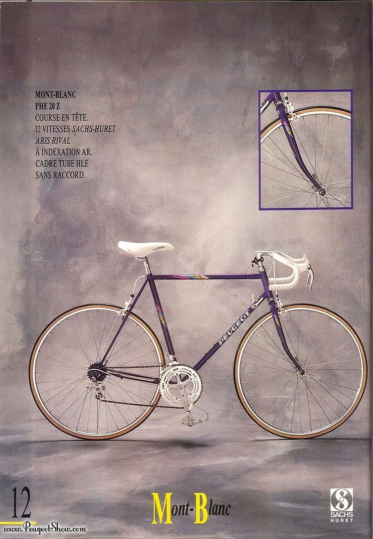

Hi,
I am looking at buying a late 80s Peugeot bike as a commuter for short distances. I am not 100% sure what model - it has the same paint scheme as this and is marked as being Mangalloy (which I guess is (slightly!) better than the Carbolite frames). The frame itself has a little rust (not too much at all) and the bike seems mostly in reasonable condition. Slight annoyances aside (It has brake lever extensions and non indexed downtube shifters.. which I will adjust to) I am considering buying it.. however I have no idea ow much it is worth. It runs well - so takes it from the <£50 skip category.. but I dont really want to pay over the odds..
Also - if I buy it, what should I be looking out for? What cn I expect to spend money on initially?
