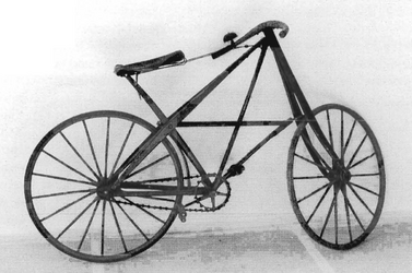

We would applaud you and support you in taking on such a project. So far as can be seen we do not have dimensions to hand. You may need to visit or contact the Copenhagen museum. We do have a Pedersen Study Guide and a page extract is provided along with an image of the wooden prototype. We organise a Pedersen Pilgrimage and have much to offer in support so do contact us libraryvcc@gmail.com

Thank you, that is very useful. It's an image with which I'm familiar, but this is the first version I've been able to read the labels.
The image above doesn't actually project onto paper based on the dimensions and angles on it.
It's like a sketch in a notebook, not in any way an attempt at a scale drawing.

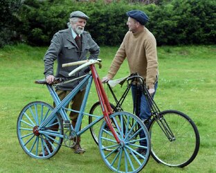

Here's something that recently surfaced online, which intrigues. No other info, yet it shows what is possible! I'd love to hear from the gentleman who built it.

The wooden one would appear to be significantly different in basic design. The seat-tube (as it were) isn't free to move as on the steel one. There's that additional, horizontal brace but no vertical cables tensioning the saddle. So I would expect it to ride very differently to the steel one.
I agree, Ian.
At this stage any variable is a possibility. It isn't my intention to make a faithful replica of either, but something to satisfy my own amusement/curiosity, built on a budget.
Never-the less, should it happen, will be from the same gene pool.
