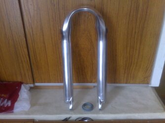

Cheers for the info everyone but have spoken to an old friend who works in spray booth who does cars, motorbikes and other items and he going to spray my lower fork legs for next to nothing.......I done all the hard work a whole day wet and dry papering off old finish then several grades of steel wool to finish they look pretty good even if I do say so myself :laugh:

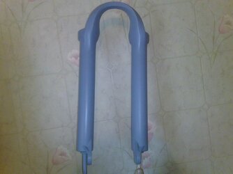

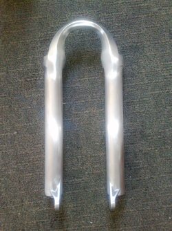

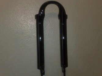

Its ok they're painted now, and I did all the hard work by hand with assorted papers and wire wools it took forever but result is worth it. I would never use any power tool or sander as they are too delicate for such abuse. They look great now just for the new rockshox decals which are in light blue to match bike decals :biggrin:
