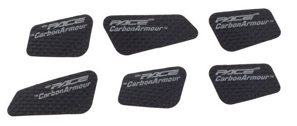

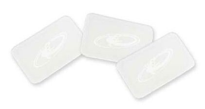

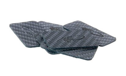

These are what I'd recommend - available from most good bike shops or online from Chain Reaction Cycles(Section; Frames and Forks / Frame Protection cost £5/£6) with free post.
The clear "Lizard Skinz" are what I normally buy. :thumbsup:
