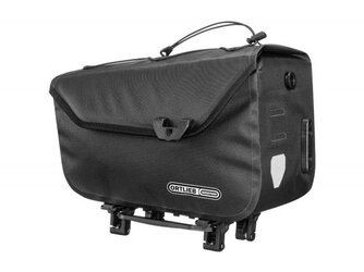

Does anyone have one of these and which pannier rack did you use?
Doesn't seem to clear the seat which means I have to sit higher or get a rack that sits further back.

Have the older version its more of a wedge shape ,lower at front. The base with the clips is adjustable so most racks would do. Are you prepared to to do a modification, unscrew the base and refix further forward. Existing holes in bag can be sealed with patch or the Ortlieb repair scew set.

Managed to find a suitable rack on my spares shelves but the brackets are too short (25mm). If I can get longer ones I might be able to set the rack further back.
Topeak have an extra long set (32mm) but seem to have delisted them. Are there any others out there?
The Topeak brackets have sorted it. Now sits clear of the seat. Decanted the rucksack without a problem. Now onto relocating the rear light.

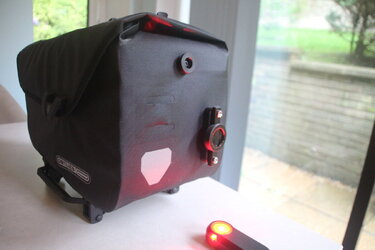

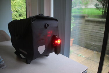

Isn't Ebay wonderful. Spent ages looking for the correct fitting for the rear of the trunk bag so I could use my Varia. Garmin fitting.
3D print specialist knocked a couple of fittings to my spec and delivered with a week. Now have the Varia on the back so I get a warning about what's coming
