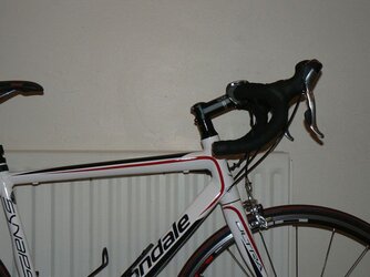

I kept looking at that pic and then my bike. I was thinking my stem doesnt look like that. I'll upload a pic and you can maybe save me from going mad but I think my stem has already been flipped?
I even took a Synapse pic from Cannondales website, superimposed it on to mine and turned the opacity down and the angles are different (I think).
And the bars are 31.8 so the CRC one wont fit :sad: Although the Deda one is listed as 31.7mm, I doubt 0.1mm would matter?

That will only go lower/longer if you flip that. You probably need a more angled/shorter one. One with the widest range is actually On One's 3D which I have and quite like and not bad for £10. You could use this to help you figure out what might work.
Thanks for that. I ordered the Deda stem last night (no patience:blush:) If its no good I can add it to the stem library :smile:

What does "angle 84 degrees" mean in the description of that stem? I assumed, being called zero, it would be totally flat, but it looks like it might have a slight angle on it.
Your head tube is going to have an angle somewhere around 73 degrees to horizontal, so a 'flat' stem, i.e. zero degrees will stick up at (90-73) 17 degrees, and an 84 degree (or 6 degree 'rise' stem) will stick up by 17 +/- 6 degrees, depending on which way you've put it on; giving the stem an effective rise of 23 or 11 degrees. If you want a totally flat stem as you look at it from the side, you'll need something with a 17 deg 'rise'.
