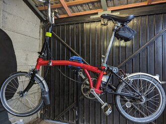

The date from the frame number matches the hub - mid 1995. Having replaced the brake cable I took it out for a brief spin, only for the left pedal crank to come adrift. I’ve refitted and torqued it up to ”pretty damn tight” so hopefully that will be that.
First gear slips under load. I don’t know if it’s in need of adjustment or a worn hub. It seems fine in all gears on the stand.

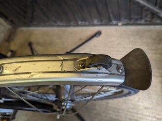

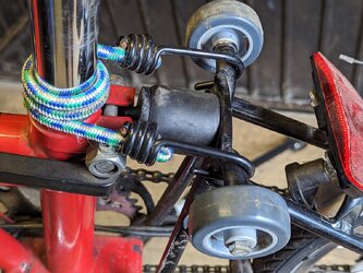

I found a couple of small castor wheels in my junk box that fit well enough so at least I can fold and stand the bike now. I’ve cut the bent part off the mudguard but the single castor seems to have pushed most of the way through so I will order a new guard in the near future.
Anyway, a couple of pics.
I went through two mudguards in the past as I do a lot of folds and unfolds during a normal commute and I normally do it in a hurry so am not always gentle.
In the end, I ordered a metal strip that sits on top of the mudguard and prevents it cracking.
They need a bit of fettling to fit - that is you have to reuse your existing single wheel (or buy a new one) and drill it out to remove it.
Adds a little more weight, but it worked for me.
