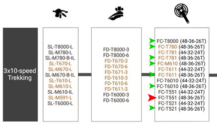

Chainset = Shimano T551 (3 chainwheels)
Chain = KMC X10 with 114 links.
Cassette = Shimano CS-HG500 10-speed
