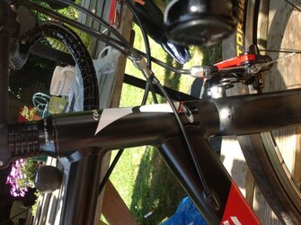

Does anyone else think the gap between my frame and the upper seal looks big? I was adjusting my stem this morning on the stand when the whole fork dropped out. I've put everything back as it was but I don't remember that bigger gap at the top or bottom but can't see how it could be any other way???
Thanks

start again. its too much of a gap!

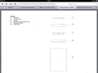

So my headset is a FSA Orbit I've taken it apart again and the only thing I can think of that I've got in the wrong order are two very thin metal washers that I was putting directly over the bearings. I'm not sure what they are for but if I move them to above the compression ring the fit is a lot closer. I've found this image online but can't find anything that shows me what these washers are???
