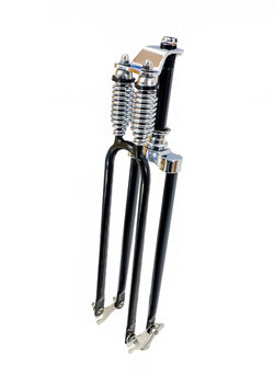

If the original front fork is fixed , how does the additional front Springer fork work?
Also, haven’t come across pedal braking and how does that work ?

I’m curious about the springer fork too Looks interesting.
I suspect the pedal brake is what we call coaster brakes. Activated by going backwards on the pedals.
Correct! It can be tricky since you also go backward on the pedals to shift gears. If you go back slightly it shifts gears, if you go backward more it brakes. If you are going smoothly to braking it is not supposed to shift but sometimes it does, a slight pain in the ass but since it is only a two speed it is not a big deal to do a quick shift if you find you are in the wrong gear.
As you can see the back part is where the original fork would be. wheel attaches to front part. when a bump is hit the part holding the wheel can rotate on the nuts attached to the back part allowing the front part to move up and down on the springs to absorb shocks.
