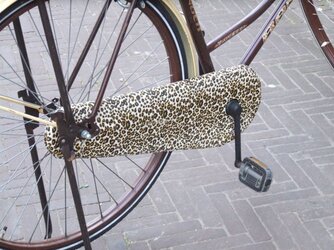

If it's that new, I'd suspect it's initial surface oxidization that can be easily addressed by a swift application of a swede brush, a dunk in gunk, a cleanse with hot water, a wipe down, a spray with PTFE spray and then an oil. (Other cleansing techniques may vary.:whistle:) In other words, don't let it get any further and, in this weather, give the chain a good wipe after every ride.
....................and get yourself a chain cover to minimise further deterioration.
2010_0712eidebarge280481.JPG .
:smile:
